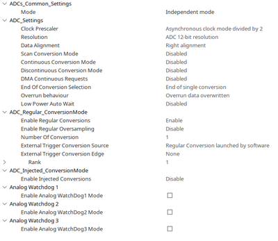

Sorry for the lack of detail. I assume this is a known thing that I didn't know.
The situation is pretty simple.
I have PC2 set up as IN3 on ADC2 singled ended.
I have PC3 set up as GPIO_EXTI3
STM32CubeIDE flags PC2 with a yellow caution. The message says "IN3 conflict with PC3 mapped as GPIO_EXTI3".
I also have IN1 and IN2 hooked up and they work fine. I also have eight other ADC inputs on ADC1 and they work fine.
A simple test is to ground PC2 and it does not read zero or even close. It reads ~2000(raw adc value).
Next, I reset PC3 so it is no longer an input, the warning goes away and now PC2 works as expected.
Maybe the Cube is generating bad initialization code? I guess it could be but seems pretty straight forward.
Perhaps my ADC settings(below) are causing the conflict?
As stated, all the other ADC inputs work fine, so I am confident the code is sound.

I don't see a reason why the configurations of PC2 and PC3 should interfere with each other.
I never experienced such an issue on any part I worked with - although a L4 device was amongst them.
It is well-known that Cube has more than one bug.
I would suggest review the actual peripheral register settings after the setup routine in a debugger.
This requires some reading and cross-referencing with the MCU's RM, though.
You have 9 inputs on the ADC but the initialization code only shows 1. There's nothing wrong with what you've provided. The bug is elsewhere.

Thanks everyone for not letting me be lazy. I should have gone with my gut(I have been doing this a long time). I assumed I was doing something and wasn't, but was fooled by the data.
Basically, I thought I was doing a read/modify/write and was really doing just modify/write of the ADC2 config.
