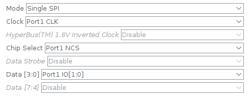

I'm trying to configure the OCTOSPI1 bus as Single-SPI to read the status register of an external memory (MRAM).

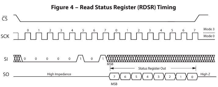

What I expect to see on the scope
0693W00000JP5s9QAD.pngWhat I really see:
  1. The MCU sends the comand (0x05) on the SI line, generates 8 clock cycles and pulls down the /CS line.
  2. IO1 is always 1.
Please, find below more details about the setup and code (ask me for more detais if needed):
My system
  • MCU: STM32H7B3I
  • OCTOSPI1
    • Input frequency: 129 MHz
    • Prescaler = 4 to meet max frequency constraints of the memory (40 MHz).
    • Configured as Single-SPI mode 0.

OCTOSPI Init
