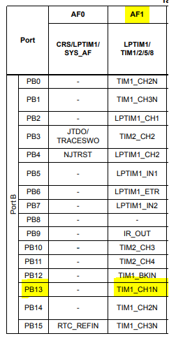

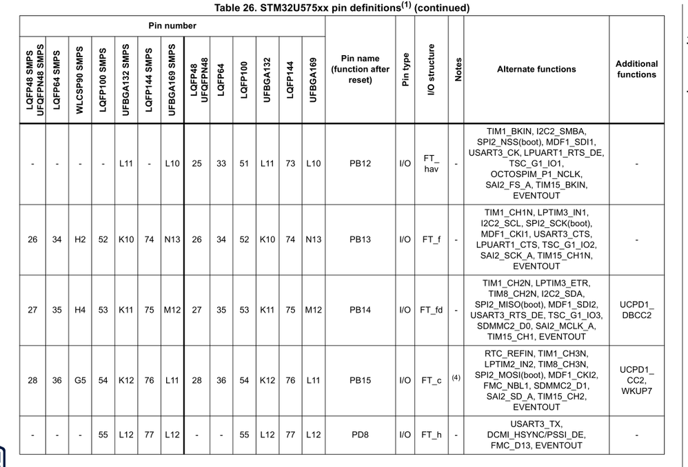

Hello everybody! Just wanted to clarify. I have still been playing with the TIM1 module. The datasheet for STM32U575ZI states that pin's PB13 alternate function TIM1_CH1N - is the first in the list, thus its number is zero. Yet, the TIM1_CH1N signal goes out only when I write "1" into the corresponding field in GPIOB AFRH register, which means that in reality TIM1_CH1N signal is actually the alternate function no.1, not zero. Does it meant that the datasheet is incorrect, or I simply misunderstand something?

it's in paragraph 4.3 Alternate functions, table27 alternate functions AF0 to AF7 in stm32U575xx datasheet rev7

It is AF1 actually, as indicated in the datasheet
Oh! It seems that I have been using either a different datasheet, or look at a different page as I don't have such a table. Could you please let me know the file and the page, where I can find this table? Please!!
I only have this:
Found! Thank you so much, Sarra!​
