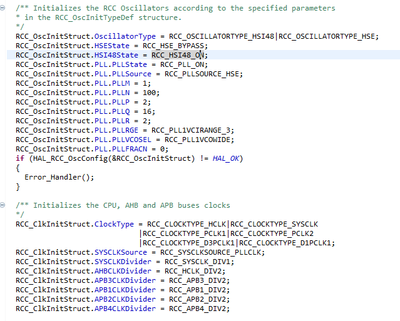

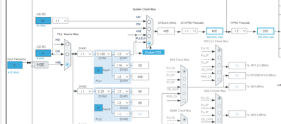

Both NUCLEO you mentioned do not have a mounted crystal at HSE and are supplied by the MCO of the ST-LINK for cost reasons. In your screenshot of the clock tree, however, you can see that you are not using the option BYPASS on the HSE, but Crystal/Ceramic Resonator. So it could be that the HSE is frantically trying to make a non-existent crystal oscillate and is therefore generating a deviating frequency for the STM32H755.
Unless you have soldered on a crystal of 8MHz, changed the solder bridges (SB72, SB3, SB4) and fitted the corresponding capacitors, you should stay with the MCO of 8MHz from the ST-LINK.

I checked the frequency of SB72 and fixed the configuration. With a primitive osci measurement I got something like 7.989 MHz out of it. I couldn't do a sigma check, but I didn't appear extremly stable to me. The results are basically the same as before. My timer signals are still deviated with a much bigger sigma. And on the F767 I had the same wrong setup, but somehow it appears to work. I'll check maybe the SB of the MCO on the F767 to check whether I get a perfect 8 MHz there. Is it possible that this crystal from ST-LINK is just a bad one? I thought it would be more stable than this and more accurate.

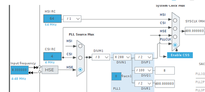

To have stable, crystal based clock, you need to re-program STLink to output 8.33 MHz (25/3). Than configure MxCube to this new frequency.
not sooo difficult, to get desired master clock
+ also : why they (STM) not set MCO to 8 MHz, as before ??? (here i show this also : DivQ1 -> mco1)
Thank you. This solved my problem for now!! :)
