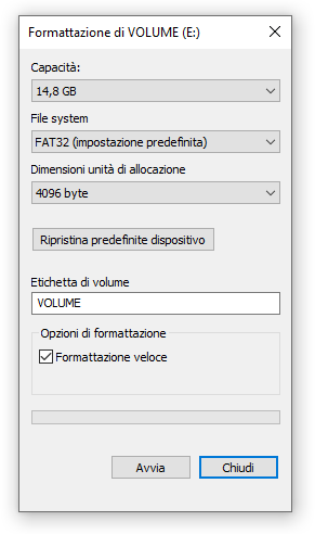

i'm developing an application with STM32F750N8 and I'm using SDMMC peripheral (48MHz clock, rising clock transition, no prescaler and hardware flow control) and FatFs library, for read and write the micro SD Card.
I tried to use a 1GB SD Card, formatted with FAT32 and 512 byte for sector size, and all works fine.
If I try to use a 16GB SD Card, first of all windows make me format it with minimum sector size of 4096 byte and, also if I set the FatFs library with MAX_SS at 4096 and MIN_SS at 512, I can't mount it. I tired also with MAX_SS = MIN_SS = 512 but nothing change.

Try to summarize: I have problems with 16's and 32's of GB SD Card.
I formatted the 16's of GB SD Card with FAT32 and 4096 cluster size:
