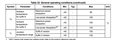

from the reference manual its mentioned that internal temperature tamper can detect when the temperature range is out of operational temperature and there is no specific data about the tamper triggering temperature range.
based on the operation condition as mentioned in the datasheet i varied the ambient temperature  but in both below and above functional range also i cant able to detect the tamper in my device .
Did you go outside of the operational range of your chip? You don't mention exact chip number so only you know what this is. Datasheet specifies this.

am using STM32U585AII6Q and already enabled the MONEN bit .
and here i varied the ambient temperature from -45 to 110 degree using a temperature chamber.
