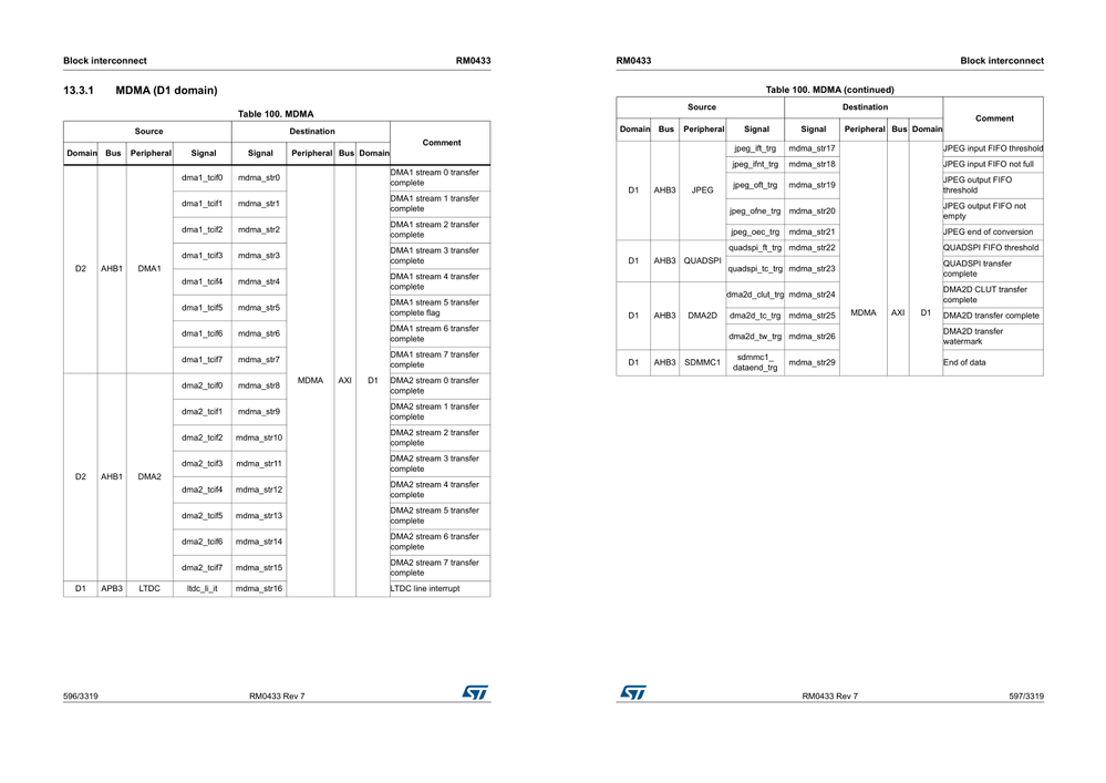

I am using STM32H7. How do I make a request to MDMA using a timer as a trigger?

Check what DMAMUX type sources are described in the Reference Manual, then use those...
‎2022-06-03 1:53 PM
You can't, at least not directly and not in 'H743 and kin. The MDMA triggers are fixed:
The indirect way would be to trigger any dummy single-transfer with the timer in DMA1/DMA2, and then the transfer complete would trigger MDMA.
