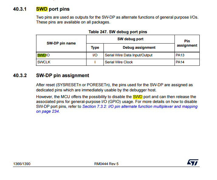

I am using the serial wire debug SWDIO and SWCLK on PA13 and PA14 to program an stm32g031. Can I use these pin after the debug? If yes, do I have to modify some dedicated register (in addition to the GPIO registers) to use thiese pins as GPIO?

I am not interested in using the NRST pin as GPIO but only the PA13 and PA14 as GPIO
So your opinions are that I should simply code them as GPIO without any other cautions? Neither on the debug side?

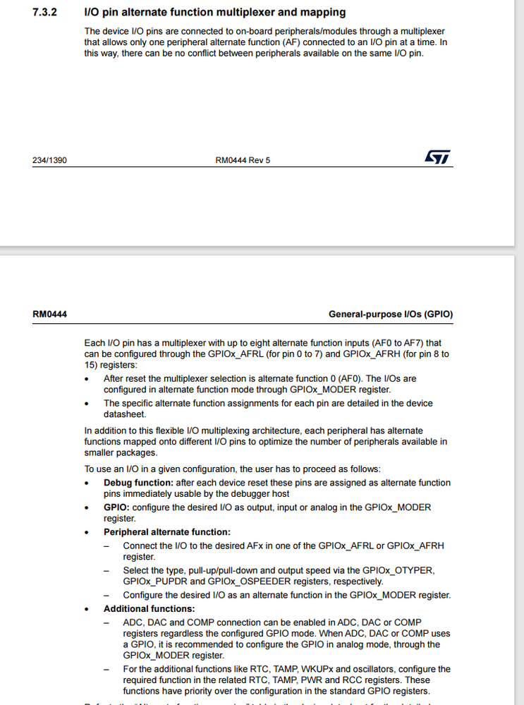

What I found in the manual does not help me a lot. Can you take a look at this?

I don't have first-hand experience with 'G0 in particular, but this is what I did/do in other small-pin-count models, .eg. 'F0 and 'L0.
