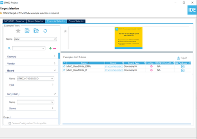

Thank you for your reply @mƎALLEm !
I was referring to the following examples seen in STMcubeIDE
I understand that your code is like a template, I would have to pass it to a project created from 0 by me in stm32cubeIDE, right? because I copied the emmc.c and .h files that you indicate me and if I compile it I get the following message also does not have the .ioc as to see graphically the configuration. error code above (I don't know why I don't see it below)

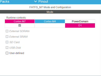

When creating an oriyecto from 0 configuring it as it is in the HTD I missed in fatfs_m7 that I would not know what options to select.
I share the project to see if maybe I missed to configure something before or just the fatfs to be able to pass the emmcc and . h and what you passed me in the main.c and start debugging to understand the steps.
mƎALLEm
December 2, 2024
There is no available project from scratch. You need to configure your ioc file by following the parameters in these examples.
