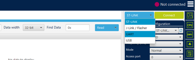

Shirley.Ye
you can use the bootloader inside the System memory to update the FW via VCP.
Read AN2606 to configure for the bootloader. usually need to configure the boot pin.
then in the cubeprogrammer choose UART,connected. VCP is communicating in UART communication.
then you can update the firmware.
Can you?
There is no mention in AN2606 of configuring the USB bootloader to use VCP.
Are you thinking of using an external VCP (USB-to-UART converter) to connect to the STM32's UART bootloader?
I don't think that's what @No_Name is asking about?
I think @No_Name wants to implement VCP on the STM32F40's USB, and update the firmware via that?
