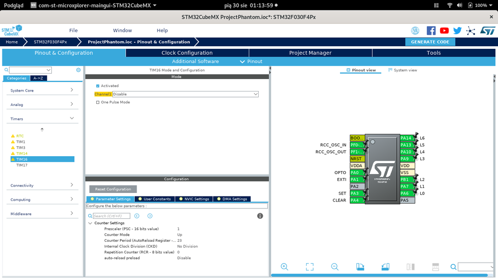

Im using F030F4P6 controller. Here's TIM16 configuration:

‎2019-08-29 4:41 PM
>>Doesn't know why
Start by using the debugger, and check to see that TIM16->CNT increments.
htim16.Init.Prescaler = 1; // Needs to be MHz of TIMCLK -1 (here assumes TIMCLK = 2 MHz, is that correct?)
htim16.Init.CounterMode = TIM_COUNTERMODE_UP;
htim16.Init.Period = 23; // Needs to be maximal, ie 0xFFFF

Unfortunately 1 MHz is impractically fast to interrupt, which is why the TIM->CNT method is normally used.
I would tend just to initialize the TIM once, and read the TIM->CNT start value, and then delta the count as it increments.
ie
uint16_t start = TIM16->CNT;
while(((uint16_t)TIM16->CNT - start) < delay);
