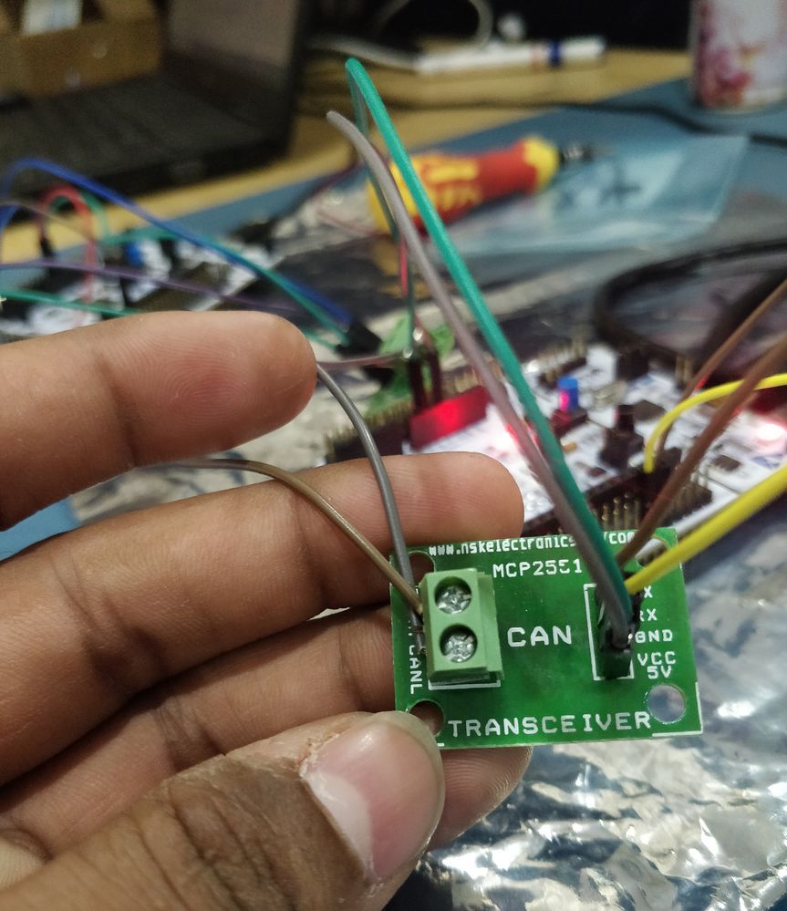

I am using network example with two evaluation board along with MCP2551 CAN tranceiver. One board I configured as tx and another as rx, but I am not able to receive the data in Rxdata buffer
suggest me something.

Don't the EVAL series boards​ have CAN ports and transceivers already?
What board specifically do you have? A DISCO or NUCLEO? ​
utamb
No CAN transceiver. It is NUCLEO. MCP2551 CAN tranceiver I am using.0690X000006CGzUQAW.jpg
