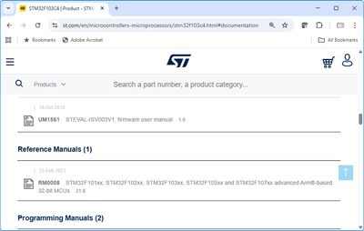

@Bags wrote:
Can't remember where I got the PDF from :o)
All documentation will always be available on the 'Documentation' tab of the Product Page for the chip in question; eg, for STM32F103C4:
https://www.st.com/en/microcontrollers-microprocessors/stm32f103c4.html#documentation
So that's always the place to check for the definitive version.
So Feb 2021 Rev 21 is, indeed, the latest:
