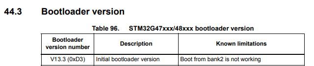

Imen.D
Hi @ASank​ ,
As stating on the AN2606: the dual boot is not working on the bootloader V13.3.
0693W000008zMh6QAE.jpgImen
