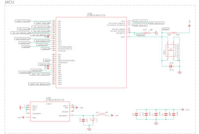

At this point the communication fails and UART sends only zero. This is even weirder: if I press the reset button on the board (schematic attached), the communication starts working again. Honestly, I cannot understand why the communication fails when the supply is turned off and it recovers after pressing the reset button. Any idea?

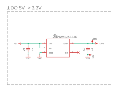

Typically there is no external pull-up on NRST, just the cap to GND.  I wonder if the resulting power-on reset pulse is too narrow for a valid reset?  That may also happen if your 3.3V supply takes too long to ramp up.  You don't show your power supply section.
Check the UART output with a scope and make sure it really is sending at 9600 baud (when you see '0' characters).
Where else does your "BOOT0" signal go?  If there is anything connected that may allow that pin to be seen as "high" during power-on, that would force the built-in bootloader to run instead of your code.
You don't have a crystal or oscillator on PH0/PH1, so what is your clock source?

Unfortunately this happens even if I don't pull up the NRST pin, so if I desolder the 10k resistor. Here you go the full overview of the MCU:
The BOOT0 signal actually doesn't go anywhere else. It is only pulled down.
About the clock, I use the internal source.
