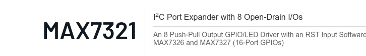

‎2022-12-12 10:19 AM
if needed speed is not very high, i would use a port expander, ie:
- 3 of them make 24 lines with an active-low INT Output Alerts Change on Inputs
