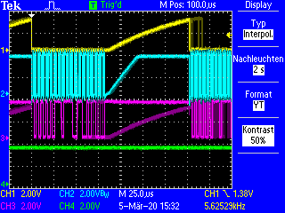

  • When I want to use the hardware NSS, I have to disable the SPI-periphery by LL_SPI_Disable(SPIx) after one message has been send, so that the NSS-signal will be set to high again. but it seems that the NSS-pin is not active pushed to the high-level after sending the LL_SPI_Disable() command, which results in a very slow rising voltage. I assume that the SPI-pins are just set into tristate mode in this case. Pull-Up resistors decrease the time of the rising edges, but are still not perfect. (Yellow = NSS, Cyan = CLK, Purple = MOSI). This is a very crappy behaviour, which means the hardware-NSS function cannot be used this way! Or is there a way to control the NSS-pin when it is in hardware-mode, so that it is pushed to the high-level as it should?0690X00000DYnRuQAL.png

1) It would be ok for me and all applications, that the NSS-signal is pushed to a high-level, when you disable the SPI function block. But the signal is not actively pushed to a high level, like I would expect from the push-pull-output, as you can see in the image of the scope. Reenabling the SPI immediatelly after disabling it will not cause a valid edge. This is what you can see in the image. And because this does not generates a valid edge/pulse, you cannot use it at all because it will always be luck whether or not the slave will actually interpret the NSS-signal as valid high-level.

Please have a look at the image in my first post. The yellow curve is the NSS signal. The command LL_SPI_Disable() has been called a bit to the left of the middle of the screen (where CLK in cyan ends). The command LL_SPI_Enable() was called immediatelly after that! As you can see, this is no edge as you would expect it... Oh and a pull-up (as already written in the first post) does not fix this problem! It will make the slope a bit steeper, but still not as you would expect it...
