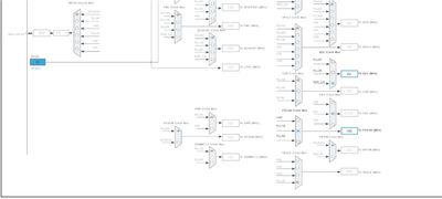

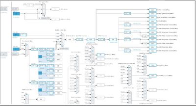

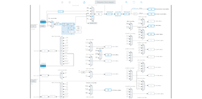

1. Clock Configuration of STM32G0B1CBT6 with baudrate 12.5 kbps:
hfdcan1.Instance = FDCAN1;
hfdcan1.Init.ClockDivider = FDCAN_CLOCK_DIV1;
hfdcan1.Init.FrameFormat = FDCAN_FRAME_FD_NO_BRS;
hfdcan1.Init.Mode = FDCAN_MODE_NORMAL;
hfdcan1.Init.AutoRetransmission = DISABLE;
hfdcan1.Init.TransmitPause = DISABLE;
hfdcan1.Init.ProtocolException = DISABLE;
hfdcan1.Init.NominalPrescaler = 10;
hfdcan1.Init.NominalSyncJumpWidth = 2;
hfdcan1.Init.NominalTimeSeg1 = 15;
hfdcan1.Init.NominalTimeSeg2 = 5;
hfdcan1.Init.DataPrescaler = 10;
hfdcan1.Init.DataSyncJumpWidth = 2;
hfdcan1.Init.DataTimeSeg1 = 15;
hfdcan1.Init.DataTimeSeg2 = 5;
hfdcan1.Init.StdFiltersNbr = 1;
hfdcan1.Init.ExtFiltersNbr = 0;
hfdcan1.Init.TxFifoQueueMode = FDCAN_TX_FIFO_OPERATION; 
2. Curren Configuration of STM32H743 with baudrate 12.5 kbps:
  hfdcan1.Init.NominalPrescaler = 20;
  hfdcan1.Init.DataPrescaler = 20;
  hfdcan1.Init.MessageRAMOffset = 0;
  hfdcan1.Init.RxFifo0ElmtsNbr = 1;
  hfdcan1.Init.RxFifo0ElmtSize = FDCAN_DATA_BYTES_12;
  hfdcan1.Init.RxFifo1ElmtsNbr = 1;
  hfdcan1.Init.RxFifo1ElmtSize = FDCAN_DATA_BYTES_12;
  hfdcan1.Init.RxBuffersNbr = 0;
  hfdcan1.Init.RxBufferSize = FDCAN_DATA_BYTES_12;
  hfdcan1.Init.TxEventsNbr = 1;
  hfdcan1.Init.TxBuffersNbr = 1;
  hfdcan1.Init.TxFifoQueueElmtsNbr = 1;
  hfdcan1.Init.TxElmtSize = FDCAN_DATA_BYTES_8;
Will be trying to reduce the prescaler and HSI calibration feature if any.
