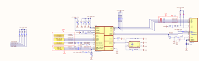

I am using STM32F767 with LWIP and LAN8742 PHY.
Ethernet initializes but I am facing Ping does not work reliably.
This is the Schematic.

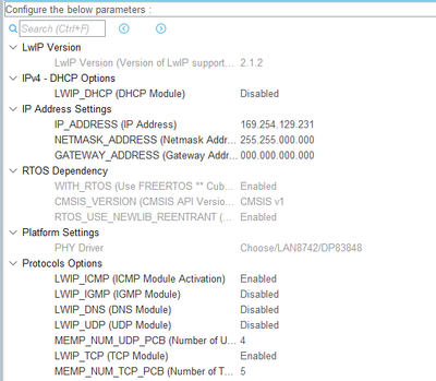

Using the same firmware and LWIP configuration, Ethernet ping works correctly on the Nucleo-F767ZI and another custom STM32F767-based board. On this custom PCB, however, the device does not respond to ping.

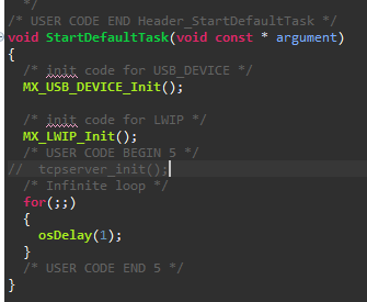

This is my code snippet used to ping the IP address. I am using only the libraries provided by STM32CubeIDE, and no additional custom code has been added.

@Vinayak_B_H  the PHY and Ethernet pins wiring is crucial, and it is not really visible from your schematic snippet. If you could provide a complete Ethernet schematic snippet in adequate quality, that might help a lot.
