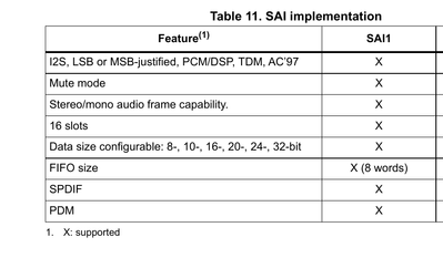

Please provide a sample code to interface a Sigma-Delta type ADC like the ADuM7701 with the STM32H562RIT6, which does not have a DFSDM unit, and guide me on optimizing the code so that the microcontroller is not solely occupied with processing the MDAT signal from the ADuM7701.

so on cpu without DFSDM  , could try using the SAI : PDM mode
But:
So look on git, sure you can find some pdm->decimation filter , then write your program.
