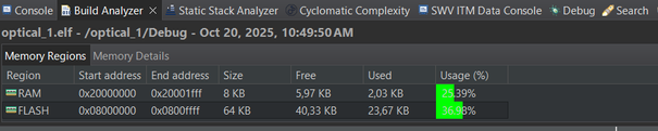

Does the STM32G030F6P6 microcontroller have 32kb or 64kb?
Baris_Simsek
-->According to the datasheet and reference manual, I learned that the microcontroller has 64KB of memory, and I tested it and was able to read/write on pages 29, 30, 31. But why does the website say it has 32KB?

So the STM32G030F6P6 has 32K flash, working and tested.
But the chip might be the same as STM32G030K8 , so it has 64K always - but not tested for 100% error free.
So you can use > 32K , but be aware, its just luck, if this working , and no guarantee every chip doing it.
You payed for 32K working flash, thats it. Even if they use always the 64K die, to reduce costs.
Where, exactly, does it say that?
Please provide a link & screenshot.
I understand, 32KB is enough for me, but I asked out of curiosity. If I need a larger size in the future, I can at least replace the microcontroller. Thank you.
