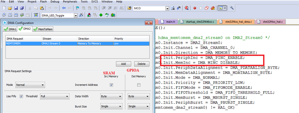

I am transferring bytes from SRAM to GPIOA ODR . really confused after seeing the code generated by cubemx.
here is a snapshot (SRAM is src and GPIOA is dst )
Why ''MemInc'' is disabled ? perhaps it treats Dst memory address as ''MemInc'' ?
Please help to clarify

In MEM2MEM mode, 'peripheral' means source, 'memory' means destination.
However, I doubt you want MEM2MEM mode. How do you trigger the DMA?

And you don't mind that the data will be output at the maximum possible rate?
