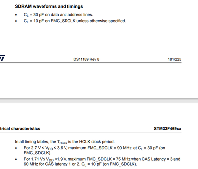

Please make sure that the SDRAM clock frequency does not exceed the maximum supported value. You can fin the maximum FMC_SDCLK in the datasheet.
Also, I recommend you to start with verifying SDRAM timing and LTDC configuration, then proceed to signal integrity checks.

  1. SDRAM bandwidth (40% margin with SDCLK at 72MHz @ 3.3V)
