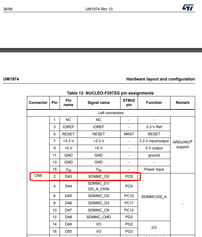

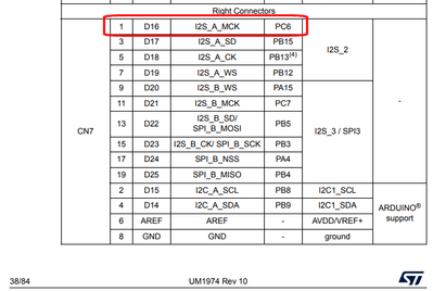

I couldn't understand the pinout of the nucleo board
Here in CN8 the blue side pins is mentioned with both D43 and PC8. same in CN7 pin number 1 is mentioned with both PC6 and D16. But which of pin is actually connected to this specific header.

The A... and D... names are just for Arduino reference. The STM32 names whcih you also find in the data sheet, STM32CubeMX,... start with P for Port and a one letter + a decimal number in range 0..15 like PC8 etc..

Also, the User Manual has tables showing which connector pins connect to what STM32 Port pins:
D43 on CN8 connects to PC8 on the STM32:
D16 on CN7 connects to PC6 on the STM32:
The Dxx pins are Arduino / Nucleo Morpho designators, not to be confused with PDx pins on GPIO Bank D
Other Pxy designations are for the IC. Check schematics and data sheet to assuage confusion and doubt..

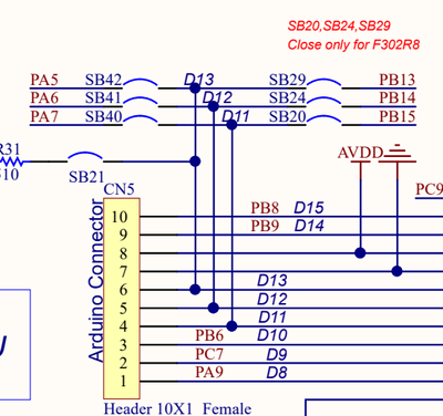

Refering to the schematic, I am left with one more confusion.
Here in CN5 , referring to D11,12 & 13, lets say in D11, am I right that if the SB20 jumper is closed then the D11 is connected tp PB15 of the microcontroller and if SB40 is closed then it is connected to PA7 of the STM mcu right ?
Correct.
SB = solder bridge. So you need a soldering iron to open/close. The user manual should have the default settings of those for your board.
