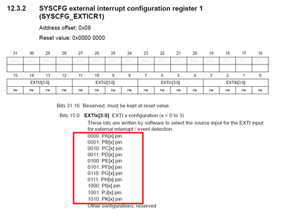

I want to confirm the limitations of GPIO interrupts on STM32 devices.
I am using an STM32H7 device, and observed that interrupts cannot be configured for PA0 and PB0 at the same time. I could not find any confirmation regarding this in the device datasheet,can anyone give me the confirmation on this.

If you refer to the reference manual / SYSCFG_EXTICR[n] register, you find that only one IO on x position could be configured as EXTI input at a time:

Hello @sarun
PA0 and PB0 and so on, are connected to Line0, so you can use only one pin at one time to handle interrupt from there.
