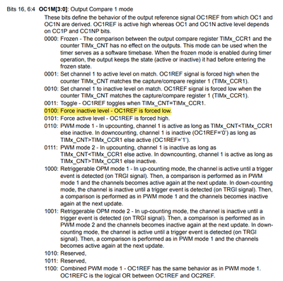

Hello everyone,
I’m new to STM32 and I’m currently stuck with using timers.
I’m working with an STM32F303RE, and the goal of my project is to generate 6 signals at 100 kHz (high time between 100 and 500 ns), each phase-shifted by 60°. These signals will be used to phase-shift power commands, in order to limit current spikes by staggering their switching times.
For now, I’m focusing on generating just a single 100 kHz signal with a longer high time so I can easily observe it on an oscilloscope (precise timings are not important at this stage).
To generate the signal, I thought about using the combined PWM mode of Timer 1. If I understand correctly, this mode allows the output to go high when the timer reaches CCR1, then go low when it reaches CCR2, and remain low until the ARR is reached or the timer restarts. This method has the advantage of potentially generating 2 (or 3?) signals using TIM1 and CCR1–6, and makes it easy to handle phase shifts.
I have already tested standard PWM with TIM1 and output them on the board pins; I can clearly see the signal on PA8 on my oscilloscope with the correct frequency, so my external setup works fine.
However, as soon as I switch to the combined PWM mode, nothing comes out of the board.
Being a bit lost, any help would be greatly appreciated, especially regarding the points below:
  1. Do you have a simple working PWM combined example that could help me understand what I’m doing wrong?
  2. Do you have any idea what might be wrong in the attached code?
  3. At the moment, I generate my signal using CCR1 and CCR2. I could generate another one with CCR3 and CCR4, but CCR5 and CCR6 do not have external outputs, so they cannot generate signals. However, would it be possible to pair CCR1 and CCR5, CCR2 and CCR6, CCR3 and CCR4 to get 3 signals from TIM1?
    I was hoping (although I could manage with an additional timer if needed) that I could use the PWM combination of CCR1 and CCR5 on OC1REF and thus benefit from CCR5 even though it doesn’t have a directly accessible GPIO. And similarly for CCR2 and CCR6.
Thank you very much to anyone who can help.

> // --- Set/Reset mode ---
> TIM1->CCMR1 &= ~((7 << TIM_CCMR1_OC1M_Pos) | (7 << TIM_CCMR1_OC2M_Pos));
> TIM1->CCMR1 |= (4 << TIM_CCMR1_OC1M_Pos) | (4 << TIM_CCMR1_OC2M_Pos); // 100b = Set/Reset
This sets OC1M to 0b0100 which forces the level inactive. Not combined mode. Need to set the OC1M[3] bit, which is not contiguous with the others.
No. TIM1 doesn't have CCR5 or 6 anyway.
3 REPLIES 3
waclawek.jan
Nice catch.
In 'F3, it does.
You can't combine CH6, though; but you can combine CH5, see TIMx_CCR5.GC5Cx.
The idea presumably is, that for 3 mutually shifted waveform you need to phase-shift (combine) only 2 out of 3 output channels, so you e.g. output CH1 plain, combine CH2 with CH5 and combine CH3 with CH4.
For the remaining 3 channels, you'd need to use a different timer (TIM8/TIM20) - how exactly would you synchronize them depends on the particular application. If the frequency never changes, then it's enough to start one timer used as master, set up an appropriately phase-shifted CHx used as TRGO; in second timer set slave-mode to be triggered from first timer and Slave-mode controller set to Trigger, and don't enable counter of second timer manually, wait until slave-mode controller enables it; after that you can reprogram CHx in first timer as needed.

Hello TDK, hello Jan,
thank you both very much for your help and explanations!
Indeed, the issue was exactly what you pointed out:
I was setting OC1M = 0b0100 instead of enabling the extended OCxM[3] bit required for the combined PWM mode. After fixing this, I was finally able to generate a proper waveform using CCR1 (set) and CCR2 (reset), exactly as expected.
I can also confirm that CCR3/CCR4 work the same way.
Regarding CCR5/CCR6:
after more experiments, it seems that CCR5 cannot be used to directly generate a “normal” output waveform like CCR1–4. As Jan mentioned, CCR5 is only intended for the group channel mode (GC5Cx), which performs logical OR/AND operations to force or combine the outputs of CH1, CH2 and CH3.
Because of this, CCR5 does not drive its own compare event and cannot toggle/set/reset a dedicated output pin.
So although CCR5 can influence the three main channels, it cannot be used as a second compare unit for CH1 to generate an additional pulse edge. This prevented me from producing three phase-shifted combined-PWM signals using TIM1 alone.
In any case, I will post here a minimal corrected example showing how to generate one combined-PWM signal (using CCR1/CCR2) in case it can help others doing similar tests.
Thanks again for your very useful insights!

void TIM1_Init_Custom(void)
    // Enable TIM1 clock
    LL_APB2_GRP1_EnableClock(LL_APB2_GRP1_PERIPH_TIM1);
    // --- General parameters ---
    TIM1->PSC = 0;            // No prescaler
    TIM1->ARR = 719;          // 100 kHz @ 72 MHz
    TIM1->CCR1 = 0;         // Tick at which output will be SET
    TIM1->CCR2 = 14;         // Tick at which output will be RESET
    // Configure TIM1 CH1 en Combined PWM Mode 1 (1100b)
    TIM1->CCMR1 |= TIM_CCMR1_OC1M_3 | TIM_CCMR1_OC2M_3;         // set OC1M_3 (bit 16) -> 1100b total
    TIM1->CCMR1 |= TIM_CCMR1_OC1PE | TIM_CCMR1_OC2PE; // Preload enable
    // --- Enable outputs ---
    TIM1->CCER = TIM_CCER_CC1E | TIM_CCER_CC2E; // Enable CH1 and CH2
    TIM1->BDTR = TIM_BDTR_MOE;                  // Main output enable
    // --- Start timer ---
    TIM1->CR1 = TIM_CR1_ARPE;                   // ARR preload enable
    TIM1->EGR = TIM_EGR_UG;                     // Force update
    TIM1->CR1 |= TIM_CR1_CEN;                   // Start timer
