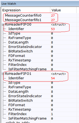

I don't have the full picture of your example as the NVIC is not shown. I don't have STM32G0B1 device to test but I've tested the same thing on NUCLEO-H563 in External loopback mode.
This is the code I did for the test and I'm receiving well on both FIFOs (1 & 0):
The following is my FDCAN configuration where FIFO0 is configured to receive even IDs while FIFO1 is configured to receive odd IDs:

The main where all IDs ins standard ID from 0 to 0x7FF are sent and received in the FIFOs.

And here is the live watch of IAR showing the headers updated with the IDs in both callbacks FIFO0 and FIFO1:

  RCC_OscInitStruct.PLL.PLLSource = RCC_PLLSOURCE_HSI;
  RCC_OscInitStruct.PLL.PLLM = RCC_PLLM_DIV1;
  RCC_OscInitStruct.PLL.PLLN = 8;
  RCC_OscInitStruct.PLL.PLLP = RCC_PLLP_DIV2;
  RCC_OscInitStruct.PLL.PLLQ = RCC_PLLQ_DIV2;
  RCC_OscInitStruct.PLL.PLLR = RCC_PLLR_DIV2;
    Error_Handler();
  RCC_ClkInitStruct.AHBCLKDivider = RCC_SYSCLK_DIV2;
  RCC_ClkInitStruct.APB1CLKDivider = RCC_HCLK_DIV1;
  RCC_ClkInitStruct.APB2CLKDivider = RCC_HCLK_DIV1;
  if (HAL_RCC_ClockConfig(&RCC_ClkInitStruct, FLASH_LATENCY_1) != HAL_OK)
    Error_Handler();
  * @brief FDCAN1 Initialization Function
  * @param None
  * @retval None
static void MX_FDCAN1_Init(void)
  /* USER CODE BEGIN FDCAN1_Init 0 */
  /* USER CODE END FDCAN1_Init 0 */
  /* USER CODE BEGIN FDCAN1_Init 1 */
  /* USER CODE END FDCAN1_Init 1 */
  hfdcan1.Instance = FDCAN1;
  hfdcan1.Init.ClockDivider = FDCAN_CLOCK_DIV1;
  hfdcan1.Init.FrameFormat = FDCAN_FRAME_FD_NO_BRS;
  hfdcan1.Init.Mode = FDCAN_MODE_EXTERNAL_LOOPBACK;
  hfdcan1.Init.AutoRetransmission = ENABLE;
  hfdcan1.Init.TransmitPause = DISABLE;
  hfdcan1.Init.ProtocolException = DISABLE;
  hfdcan1.Init.NominalPrescaler = 1;
  hfdcan1.Init.NominalSyncJumpWidth = 9;
  hfdcan1.Init.NominalTimeSeg1 = 54;
  hfdcan1.Init.NominalTimeSeg2 = 9;
  hfdcan1.Init.DataPrescaler = 4;
  hfdcan1.Init.DataSyncJumpWidth = 2;
  hfdcan1.Init.DataTimeSeg1 = 13;
  hfdcan1.Init.DataTimeSeg2 = 2;
  hfdcan1.Init.StdFiltersNbr = 1;
  hfdcan1.Init.ExtFiltersNbr = 2;
  hfdcan1.Init.TxFifoQueueMode = FDCAN_TX_FIFO_OPERATION;
  if (HAL_FDCAN_Init(&hfdcan1) != HAL_OK)
    Error_Handler();
  /* USER CODE BEGIN FDCAN1_Init 2 */
  FDCAN_FilterTypeDef FilterSetup1;
  FilterSetup1.IdType = FDCAN_STANDARD_ID;
  FilterSetup1.FilterIndex = 2;
  FilterSetup1.FilterType = FDCAN_FILTER_MASK;
  FilterSetup1.FilterConfig = FDCAN_FILTER_TO_RXFIFO1;
  FilterSetup1.FilterID1 = 0x00;
  FilterSetup1.FilterID2 = 0x00;
  if((HAL_FDCAN_ConfigFilter(&hfdcan1, &FilterSetup1)) != HAL_OK)
	  Error_Handler();
  /* USER CODE END FDCAN1_Init 2 */

 Appreciate your help and time,
Aleksandar.
As you are using standard ID, please increase the number of standard ID filters: hfdcan1.Init.StdFiltersNbr > 1
aleknestor
Hi @mƎALLEm ,
Thanks a million, this solved my issue, as well the issue I had with not able to set up filters and masks.
Highly appreciate it,
Aleksandar.
