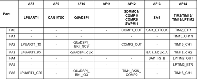

I have used GPIO_AF14_TIM16 in the GPIO configuration, since the datasheet in the manual contained the following table: https://imgur.com/a/BwVqaxh, I'm not 100% sure that it's correct though.
Does someone have an idea on what I'm doing wrong here?

‎2024-10-20 6:02 AM
The issue was unrelated to input capture, another function didn't work as expected and thus blocked the execution in the main function.
‎2024-10-20 6:22 AM
You cannot use the pin for different functions same time.
If you want do it, you have to set it to the function (AF setting) you want then,
so if using the pin as gpio , but then as af tim input, you have to switch it to this af again, before use sf function.
So set pin pa6 to af14 , after using it as gpio, before expecting it to act as af14.
