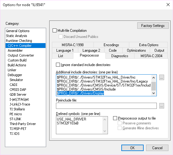

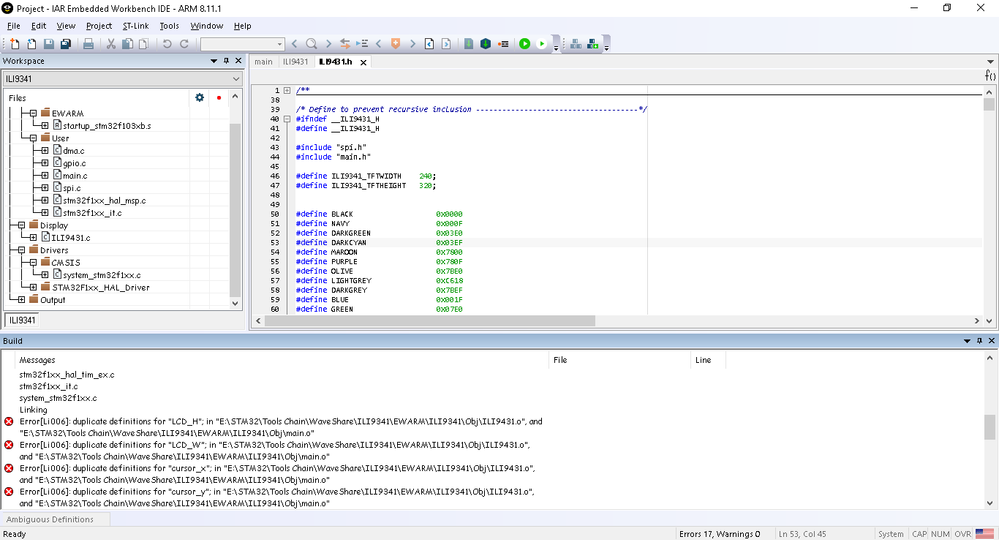

Posted on June 03, 2017 at 09:01
Hi mich.lei
In before, I am testing all(every related LCD) code in ''main.c'' and it work fine in compile.
I move all code and relative reference(include & define) to separated file(ili9341.c & ili9341.h).
Of cause, the preprocessor has updated with location for them.
Unfortunately, there have error in linking and show below.
Please help me and give me your comment.
BR
Lewis
LMI2
Lead
Posted on June 03, 2017 at 16:52
I am afraid I can't help you much with linking. I just fight back when my IDE does something odd. Besides, you seem to use different IDE  than I.
If you have a IDE/linking problem, why don't you start a new discussion about that?
