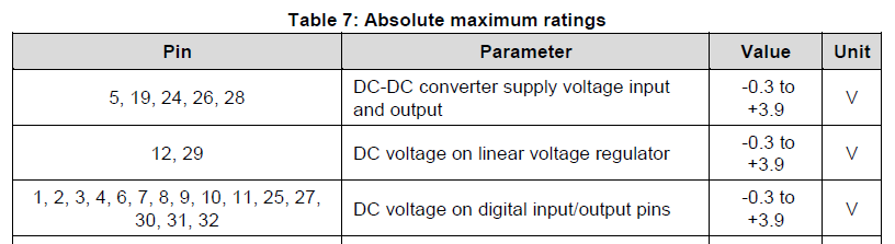

Be careful about IO levels: if you are using Arduino UNO or similar board at 5V, you will need to use level shifters as the BlueNRG chip is not 5V tolerant:
