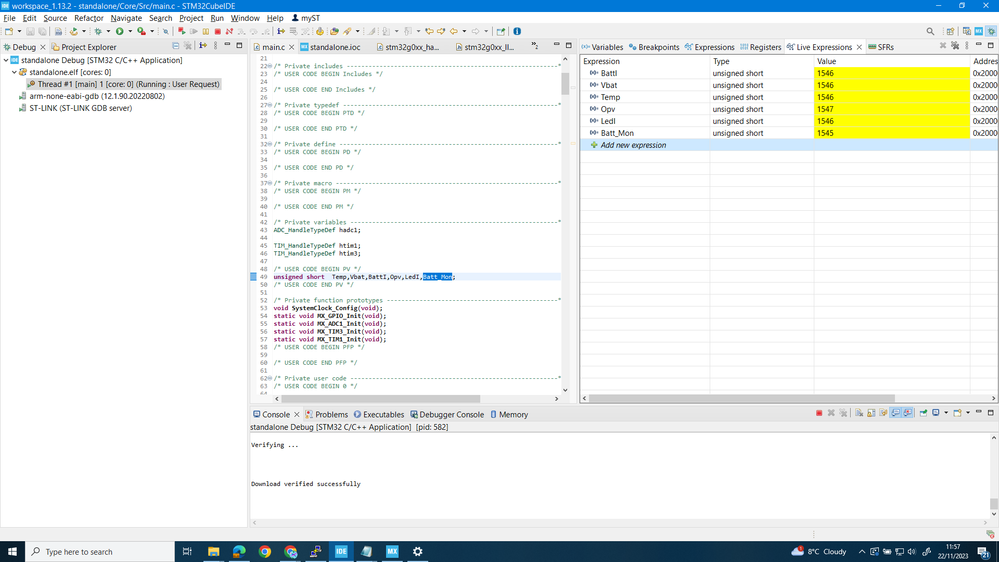

Is any otherways to read adc values for sequencer not fully configured mode as using channel 16 and channel 15.
I have tried it witout DMA but seems to getting all values same I am stuck at a project to proceed as we need adc values to proceed

Thanks for your kind response and help here i have attached the entire code and what values i am getting debugger .If you can please check.this I have done by polling

Your MX_ADC1_Init is set up to initialize the ADC for 6 conversions, but then you're trying to do single conversions. Might be other issues as well.
Perhaps go off of a working example code from the MX repository.
Here's an example for multiple conversions using DMA:
https://github.com/STMicroelectronics/STM32CubeG0/tree/master/Projects/NUCLEO-G070RB/Examples/ADC/ADC_MultiChannelSingleConversion
There are quite a few others available in the Example Selector within CubeMX for the G0 series.
meena
these examples i tried as a result reading same values for all channels
