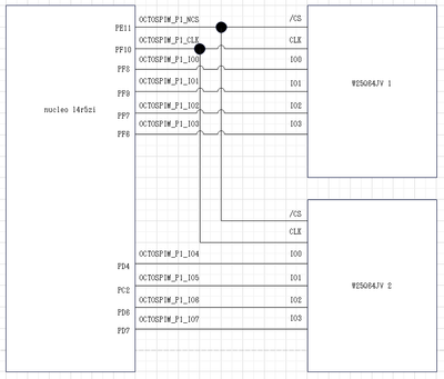

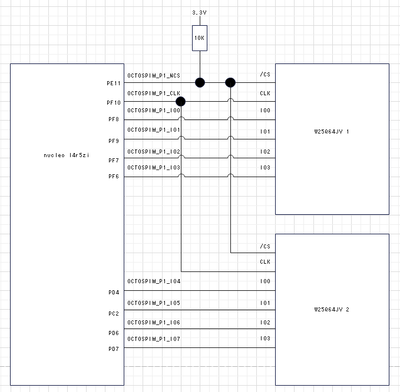

The connection diagram of the board and FLASH is shown below.

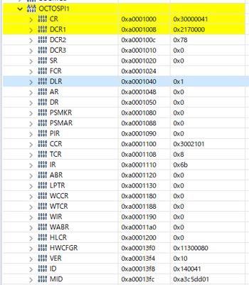

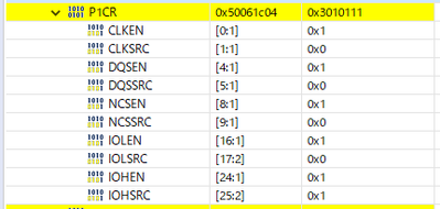

The registers are set as follows.
●OCTOSPI
●OCTOSPIM

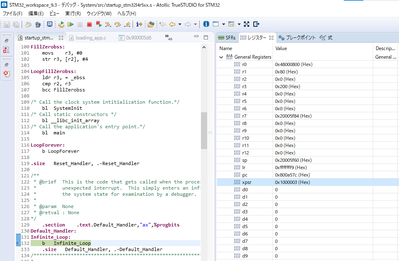

When the address of the main function of the program is set in the program counter, an exception occurs and the program cannot be executed.

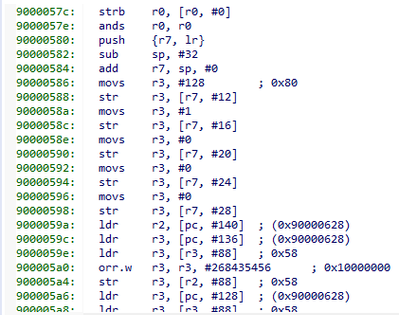

I have checked the assembly from the debugger and have confirmed that the written program is readable as expected as follows.
By the way, when I wrote the program to W25Q64JV1 only, not dual-quad-spi, and set the address of the main function in the program counter in the same way, it worked as expected.
Can you please advise if there are any register settings, etc. that are missing?

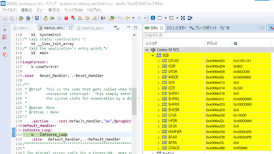

If a breakpoint is set at line 10 above and step execution is performed from there, a hardfault will occur.
I understand that a Hard Fault occurred because the 0~8 bits of XPSR are 3.
Register information when an exception occurs.

As shown below, I pulled up CS and did Excute In Place using DUAL-QUAD-SPI as expected.

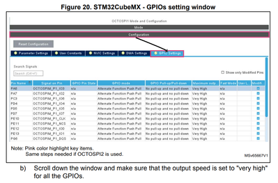

Could you please try to decrease the OCTOSPI frequency?
Also, please make sure that:
- All OCTOSPI GPIOs are set to very-high speed
- Disable the timeout feature
Thank you.
