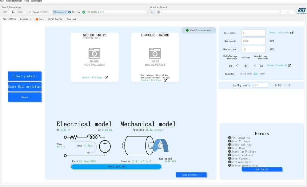

Hello Everybody,
Here are the software and boards in this case:
1. MC workbench 6.3.2
2. NUCLEO-F401RE/X-NUCLEO-IHM08M1
3.?B-G431B-ESC1

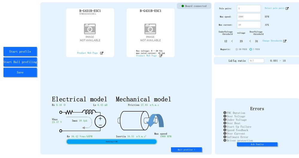

I have an I-PMSM motor, and I use two boards (one is?NUCLEO-F401RE/X-NUCLEO-IHM08M1, and the other is?B-G431B-ESC1) to run the?ST Motor Profile for detecting the motor parameters. However, the motor parameters in the two test results differ significantly. For example, the result from Board 1 (NUCLEO-F401RE/X-NUCLEO-IHM08M1) is shown in picture 1, and the result from Board 2 (B-G431B-ESC1) is shown in picture 2. We can see that the motor phase resistance is 0.23 ohms, the phase inductance is 0.62 mH, and the back EMF constant is 9.32 in picture 1. And we can see that the motor phase resistance is 0.16 ohms, the phase inductance is 0.43 mH, and the back EMF constant is 10.42 in picture 2.
Which result should I trust? Thanks!

Hello, yes, each board gives almost the same value every time, and I can spin the motor using both the profiler results and the associated boards. However, when using the motor parameters obtained from the  B-G431B-ESC1 board to run the sensorless example routine, the torque output is weak at low speeds. If you grab the rotor by hand, it will return a "speed feedback error".

Thank you for your guidance. I can spin the motor using both the profiler results and the associated boards. However, when using the motor parameters obtained from the  B-G431B-ESC1 board to run the sensorless example routine, the torque output is weak at low speeds. If I grab the rotor by hand, it will return a "speed feedback error".

Does motor profiling result with NUCLEO-F401RE/X-NUCLEO-IHM08M1 provide better results on the B-G431B-ESC1 board?

Thanks for your reply. In my case, it looks like the motor profiling result with NUCLEO-F401RE/X-NUCLEO-IHM08M1 provides better results on the B-G431B-ESC1 board.
