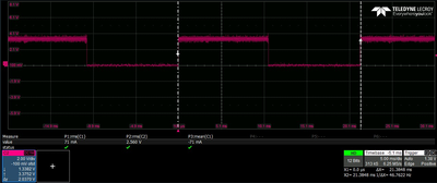

The scope capture below shows the 1,400 RPM motor HALL  or BEMF (brown trace)
Motor Speed in RPM = 2 x HALL Freq (or BEMF = same Freq ) * 60 s / pole pairs = 2 x 70.17Hz * 60s / 6 = 1403 RPM - matching the shaft speed with 140 RPM with a certified and confirmed 10:1 gear

Hello @bfa001,
In this Shinano motor use case, the targeted speed is 1400 RPM. The motor has two pole pairs, which means there are two H1 signal periods per mechanical rotation as described here. The HALL H1 signal was measured.
Motor speed (RPM) is calculated using the formula:
Motor speed (RPM) = (frequency of Hall sensor) × 60 seconds / pole pairs
For this case: Motor speed (RPM) = (1 / (21.38 ms)) × 60 / 2 = 1403 RPM. This value matches the reading reported by the tachometer.

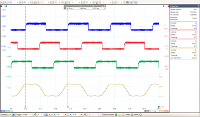

bfa001
Hello GMA,
To answer your question
Q1. "Does rotating the shaft by hand, there is 3 or 6 HALL H1 period per rotation on your side?"
A1. There are 3 periods for HALL H1 with 1 manual turn (30 with the 10:1 gear).
The equation Motor Speed in RPM = 2 x HALL Freq * 60 s / pole pairs is verified for 6 pole pairs, we have RPM = HALL Freq * 60 / 3 (for 1 motor turn we have 3 HALL periods) = HALL Freq * 60 * 2 / 6 = 1,400 RPM

Hello @bfa001,
Using MCSDK6.4.1 and the STEVAL-SPIN3202 in FOC mode:
. Close JP5, JP6, and JP7.
. Open JP9, JP10, and JP11 (not mentioned in the Workbench hardware changes tab).
With the Shinano motor, set with 2 pole pairs (2 H1 signal cycle per mechanical rotation as described in motor datasheet) in the Workbench interface and HALL sensor:
. Set a 1500 RPM command on the motor pilot.
. The motor pilot reports 1500 RPM, which is confirmed by the tachometer measurement.
Test confirmed with a 4 pole paire (4 H1 signal cycle per mechanical rotation) LIN motor.
If you agree with the answer, please accept it by clicking on 'Accept as solution'.
Best regards.
GMA
