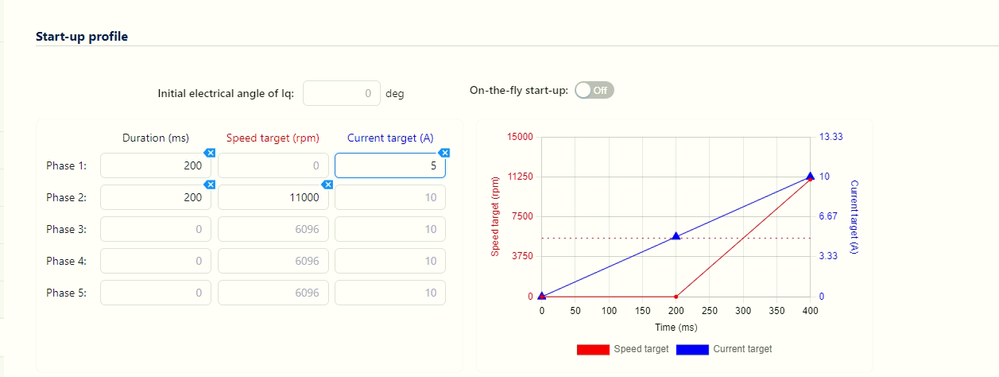

I'm using a custom STSPINF0 based board and successfully profiled my motor. Using motor pilot, I have obtained a start-up profile which I've also implemented in Motor Control Workbench (6.3.1) as shown below:

OK, I have been searching out and I see that my start-up has been saved in RevUpControlM1 handle.
So, does this mean that MC_StartMotor1() starts my motor using above handle? Executing my saved ramp?
If no, what is the correct procedure to call that handle "RUC_Exec(&RevUpControlM1);"?
If yes, then why Motor Pilot works to start my motor but MC_StartMotor1() does not?
My motor runs up to set motor RPM of 11000 but then goes into fault error no. 11 (duration).
What is the solution?
