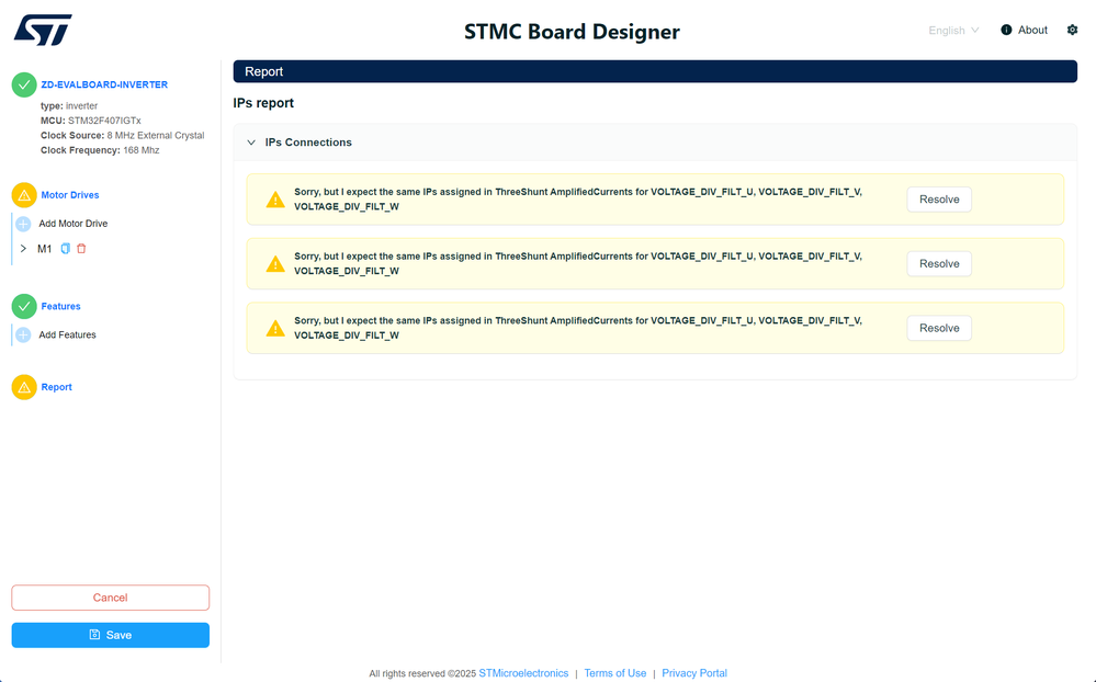

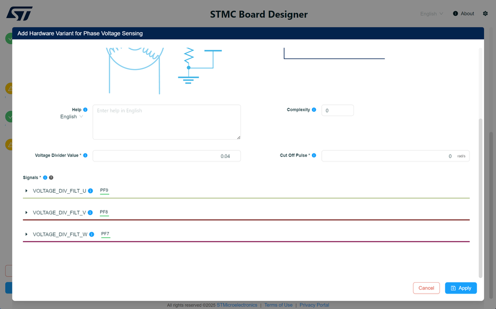

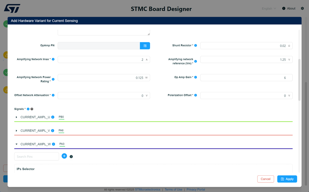

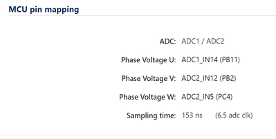

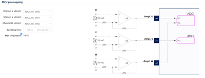

picture tells all. the resolver says these two functions have conflicting IP settings but the settings themselves apparently not.
2 REPLIES 2
Gael A
The Phase Voltage Sensing is always used in addition to the Current Sensing feature, it must observe a few rules :
  • It must use the same number of ADC than Current Sensing (2 or 3, since this is an HSO only feature)
  • It must use the same ADCs as Current Sensing too, but the order does not matter.
    • Ex : Current Sensing: U->ADC1 ; V->ADC2 ; W->ADC3 and Phase Voltage: U->ADC3 ; V->ADC1 ; W->ADC2 is possible
  • In case of 2-ADC, the used ADCs for Current Sensing and Phase Voltage must be complementary !
    • Ex1 : Current Sensing: U->ADC1 ; V->ADC1 ; W->ADC2 and Phase Voltage: U->ADC1 ; V->ADC2 ; W->ADC2 is possible
    • Ex2 : Current Sensing: U->ADC2 ; V->ADC1 ; W->ADC2 and Phase Voltage: U->ADC1 ; V->ADC2 ; W->ADC2 is NOT possible

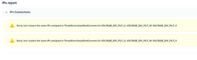

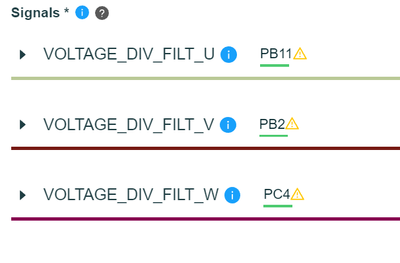

I encountered the same issue.
Everything works fine when I generate the HSO project using MCSDK 6.4.0 with a custom inverter board,
but when I open the project with MCSDK 6.4.1 Board Designer, an error occurs.

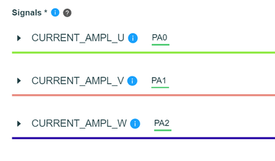

MCU: STM32G431CBU6
Pin assignment in project generated by MCSDK 6.4.0:
