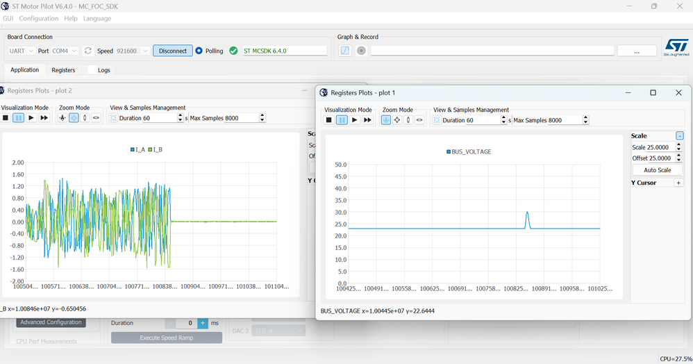

I'm encountering an overvoltage fault when decelerating a motor from high speeds. My system uses an STM32 F401RE microcontroller with an IHM16M1 driver board, controlled via Field-Oriented Control (FOC).

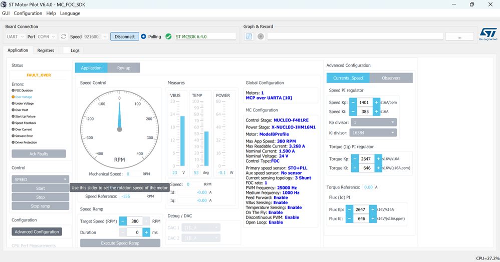

The motor operates normally at high RPMs, but when I command a speed reduction, the system immediately triggers an overvoltage fault, indicated as an "ACK Fault" in the Motor Pilot interface.
We've already tried troubleshooting the overvoltage fault on our motor controller by:
  • Increasing the voltage range in the bus voltage sensing section.
  • Following the recommended steps for overvoltage fault resolution outlined in the user manual.
Despite these efforts, the issue is still happening.
What are the solutions for preventing the overvoltage fault during deceleration?

We are experiencing an overvoltage fault not just when the motor stops, but also when we try to decrease its speed. We have already tried increasing the voltage limit, but the fault persists. Our motor is rated at 24V, and we have set the overvoltage margin to more than 30V.

The duration is available on Speed Ramp Motor Control interface:

I've followed the previous advice and adjusted the deceleration duration, but I'm still encountering an overvoltage fault. I've also checked the voltage limit settings, but I don't believe they are the root cause.
What else could be causing this issue? Any suggestions on what to check next would be greatly appreciated.

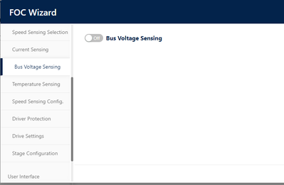

You can also deactivate the bus voltage sensing (a constant DC voltage will be used). By monitoring the VBUS value with a multimeter or an oscilloscope, you can check the VBUS range for your use case. During this test, consider the power board's rated range and DC supply limitations.
