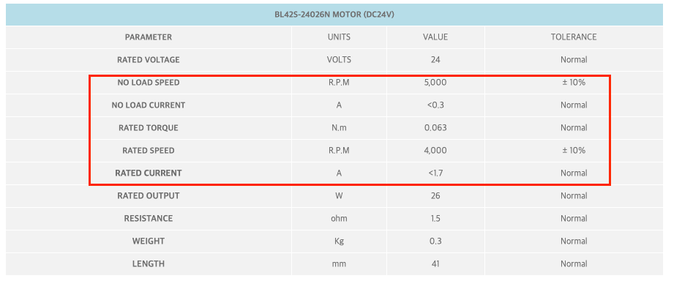

I would like to ask for your guidance regarding the motor current setting under a specific torque condition.
Based on the motor datasheet,
I derived a linear torque–speed relationship and confirmed that, at a torque of 2928.86 gf·cm,
the motor is expected to operate at 444 rpm, requiring approximately 6.6784 A according to the calculation.
The assumptions and parameters used are as follows:
  • No-load speed: 5000 rpm
  • Rated speed: 4000 rpm
  • Rated torque: 0.063 Nm (642.86 gf·cm)
The derived relationship is:
n = A × T + B
where
A = −1.55556, B = 5000
At the target speed of 444 rpm, the estimated torque is:
2928.86 gf·cm
The required current was estimated using the torque constant calculated from the rated condition:
  • Rated current: 1.7 A
  • No-load current (I₀): 0.3 A
Kt = 642.86 / (1.7 − 0.3) = 459.184 gf·cm/A
Using this value, the estimated current is:
I = (2928.86 / 459.184) + 0.3 ≈ 6.6784 A

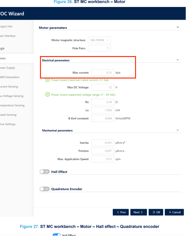

However, when measuring the same motor using ST Profiler to obtain the Electrical Model and Mechanical Model, the result showed Imax = 1.38 Apk.
Please note that:
  • The actual motor drive board is EVSPIN32G4-DUAL.
  • ST Profiler does not support EVSPIN32G4-DUAL, so the Electrical and Mechanical Models were measured using X-NUCLEO-IHM16M1 instead.
Based on this, I would like to ask whether it is acceptable to set Max current to approximately 7 Apk in order to achieve 2928.86 gf·cm torque with this motor, or if there are any limitations or concerns from the motor or driver perspective.
