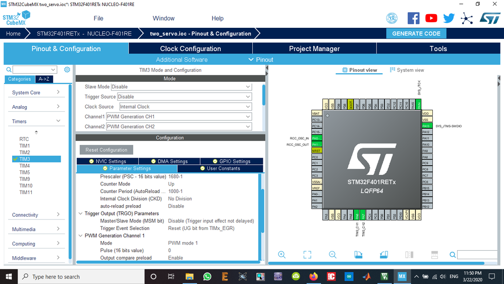

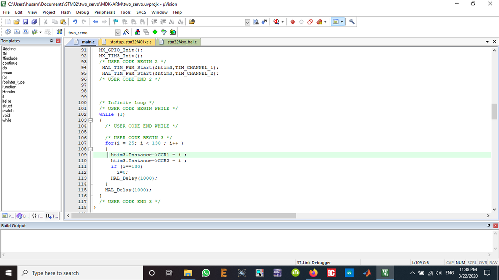

i'm trying to control two servo motor using 2 PWM output channels. when i write the code for one motor its works but when i write it for two motor there is a problem . plz any help

What is the problem?
Options
‎2020-03-23 12:08 AM
the servo motor doesn't move at all . just there is a tik tik voice but no move i dont have oscilloscope to see PWM output signals
Options
‎2020-03-23 12:18 AM
Probably inadequate power supply.
Options
‎2020-03-23 12:34 AM
thank you so much sir its work
