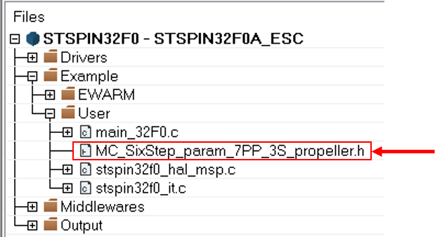

Go to the file “MC_SixStep_param_7PP_3S_propeller.h�?

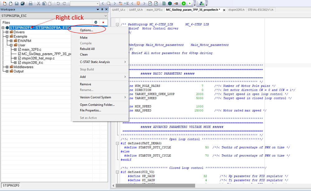

At the beginning in the "BASIC PARAMETERS" You have to modify:
- NUM_POLE_PAIRS: this is the number of pole pairs of the motor and must be set accordingly.
This parameter is directly used for speed computation, so it must be the one of the motor used.
- TARGET_SPEED: set an initial speed, the motor will start , does the ramp-up and reaches this speed, then it is possible to change the speed using specific UART commands
In order to guarantee a correct startup I would choose a speed in the mid low speed range of your application (for example 3000 or 5000 rpm).
-Also MIN_SPEED and MAX_SPEED should be adjusted according to the specific motor and application.

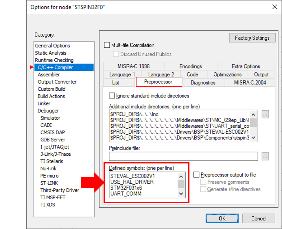

Third step: you have to modify some project defines in order to enable the UART communication and the closed loop speed control.
Right click on the project name > options… > C/C++ Compiler > Preprocessor tab
In the lower part of the window you can find the “Defined symbols�?; here is what to modify:
- change NO_UART_COMM to UART_COMM: it enables the UART communication
- change ST_PWM_INTERFACE to NO_ST_PWM_INTERFACE: this one is to avoid conflicts.
In fact it disables the reading of the PWM signal: now the speed is only set by sending UART commands
- change OPEN_LOOP to NO_OPEN_LOOP: this enables the controller to operate in closed loop
These parameters are described in the firmware user manual UM2530
