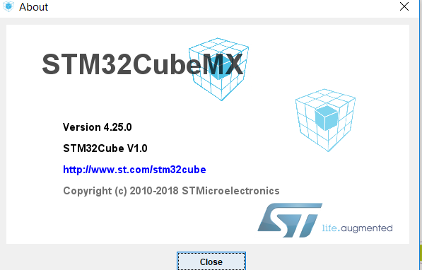

I have a project to control a BLDC sensored motor. I am not sure how to move forward. I have AC6, IAR and MKD installed. I have tried installed motor control workbench with no luck. X-CUBE-MCSDK executable that can be downloaded from the following link does not work for some reason.
http://www.st.com/en/embedded-software/stsw-stm32100.html
I am wondering if there is something else I need to install for this to work?
FIY, I am using Windows10 and I have STM32CubeMX installed.

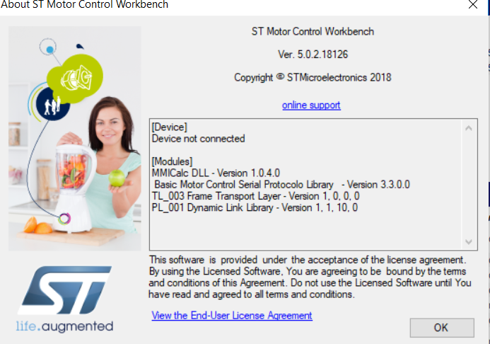

2018-04-19 3:19 PM
Thank you for your help.
You are correct. I changed the file domain to zip, and when I unzipped it, another executable showed up. I was able to run that, and it seems the problem is fixed on the server side as well.2018-04-20 9:06 AM

Could you me please let me know if code generation is successfully working ? I am fed of trying to generate code, but I having some problems in generating the code. (with mcsdk 5.0.2 or 5.0.3)
thanks a lot Abdul...

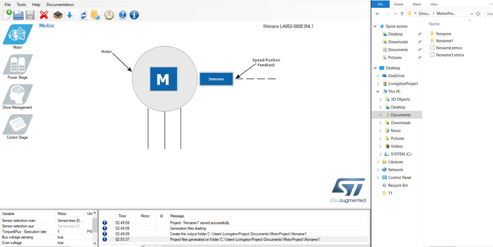

2018-04-21 5:03 PM
Hello gokay,
I think I managed to generate the STM32CubeMX project. I can't test this with my motor as the motor control program does not include the STM32F401RE board, which what ST recommends for the NUCLEO-IHM08M1 shield. The project does open using STM32CubeMX. I already tried to compile ''as-is'' with IAR and failed. I am going to try make it work without the motor control workbench software.

shield, but it's not listed in the ST motor control workbench software.I am looking into the code you provided in the link. There is a similar one for the SPIN3202. What I am trying to do right now, is to understand the code so I can start manually editing it. I knew I had to do this eventually, but I just thought there might be an ''out of the box'' solution, that is temporary until I make improvements myself. I sort of got motor spin one rotation, but I think it's designed for motors with RPM > 2000, so I need to fix that.
Again thank you for you help.
On a side note, I don't have the datasheet for the motor, so I was going to use the motor profile. I found out the F4xx series isn't supported, so I might buy a F3xx board. I am wondering if you have a recommendation? I can see the F303RE and F302R8 listed in the software.
