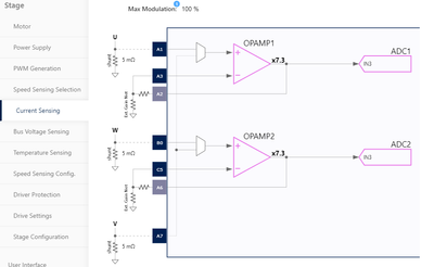

Hi there,
I am trying to configure an MCSDK6 project by reference to EVSPIN32G4.
On the page of current sensing, I see some config as below:
To my understanding, the three shunt current sensing circuits should utilize three operational amplifiers.
Why are there just two?
Thanks for the help!
Best wishes to you guys.

Hello @Junde,
The MCSDK, for the field-oriented control (FOC) 3-shunt topology of the EVSPIN32G4, uses two ADC converters associated with two internal operational amplifiers with a shared phase. Since I1 + I2 + I3 = 0, two of the three currents are sampled, while the third current is computed.
