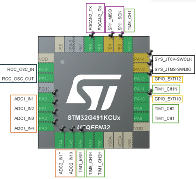

Hi, I'm a circuit engineer in korea.
I want to make really small BLDC FOC controller with STM32G491KE, because It has the smallest pin counts compare to other G491 family.
For FOC Control, I have to use three TIM channel. For use external ociliator, I have to use TIM1_CH1_CH1N, TIM_CH2_CH2N, TIM8_CH1_CH1N
If I use TIM channel with that combination, Will FOC controller work well? Is there any differences with TIM1 and TIM8?
I want to use 491KE Series for smallest FOC Controller.
Thank you.
Hello @yeseung,
A single timer must be used to control the motor.
As mentioned by @STuser2, use the MCSDK board designer tool for board design.
Also generate and compile a project to check the MCSDK compatibility.
If you agree with the answer, please accept it by clicking on 'Accept as solution'.
Best regards.
GMA
Please use the MCSDK board designer to check the feasibility of the controller and for code generation, i think it is possible but one confusion i have is you mentioned CH1 two times i hope you mean CH1, CH2, CH3.
You're right to understand.
In STM32G491KE, TIM1_CH3N pin is same as RCC_OSC_OUT, So If I use external Oscillator, I have to use other Channel like TIM8_CH1_CH1N.
Do I use same TIM number like TIM1_CH1_CH1N, TIM1_CH2_CH2N, TIM1_CH3_CH3N? Isn't it working well if I use other TIM number?

Hello @yeseung,
Best regards.
