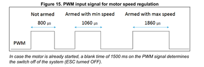

Using an ESP32 I generate a 490Hz PWM signal and first send 1060us pulses to the ESC (verified with an oscilloscope). I then send a new PWM to the ESC where the signal is high for 1850us.
My expectation was that the initial 1060us PWM would arm the driver, and then the 1850us PWM would command the ESC to drive the motor close to its maximum speed, but the motor does not move. The motor does stiffen a little and is harder to rotate by hand, and if i do rotate it by hand quickly it sometimes continues to move at a constant speed. I have also connected the ESC to the esp whilst the ESC was connected to a motor pilot on a laptop, and the motor switches from "IDLE" to "RUN" as the esp sends the PWM signal.

I am not sure if it is Hall sensor based or sensor less. If it is hall sensor then proper placement angle is required. Apart from that the PWM signal what you are providing looks fine. The below diagram is from the user manual.
Maybe you can try disabling UART in case it is loading the CPU, it is just a guess.

Are you referring to the note under figure 15 in the manual? I had thought that my signals were as the manual instructed, if a 1060us signal arms it with a minimum speed and then other signals within the 1060us to 1860us range adjust speed.
Apologies if that is not what you meant or if I have missed something in this section.
