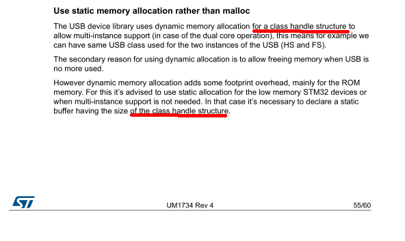

Well, I don't use CubeMX so maybe it's different in the MX-generated code, but in the Cube examples I've seen so far it was *never* the device descriptor for which memory was allocated using malloc/USBD_malloc. And, it's relatively easy to use a search facility to find out that the only place where it is used is in allocating a class-specific struct in the class drivers.
And, actually, UM1734 says exactly that:

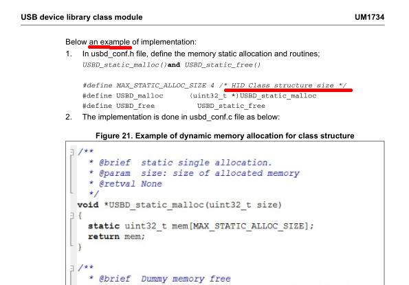

and, at the next page, it clearly says, that what's shown is an example, particularly for HID (where the respective class struct, USBD_HID_HandleTypeDef, as defined in c:\wek\stm32 misc\STM32Cube_FW_F4_V1.21.0\Middlewares\ST\STM32_USB_Device_Library\Class\HID\Inc\usbd_hid.h, consists of four uint32_t(*) - that's why uint32_t was chosen as the "unit" for that particular case):
and of course it's then the responsibility of the user to modify the example for *his* usage case - and that may be a single class different from HID, a compound of classes, or - as mentioned in UM1734 above - the same class in multiple USB device instances (using OTG_FS and OTG_HS).

I just wanted to point out that it's not the *device descriptor* (that would also be shorter, btw) which goes into the malloc-ed space.
Also - as you mentioned, RAM is a valuable resource - the CDC class struct does not necessarily need to be 540 bytes - most of it is taken up by a packet buffer, but for example in FS, MAXPACKET is 64 bytes.
