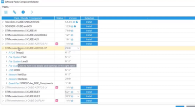

Hello @Gil1
I think you can delete the current version of the X-CUBE-AZRTOS-H7 and download the version that use the ThreadX V6.1. Also, on your .ioc file, you can go to Pinout & configuration -> Software Packs -> Select Components -> open the menu of X-CUBE-AZRTOS-H7 and select the ThreadX version you want:
Sorry for the screenshot (it is not up to date).
Best Regards.

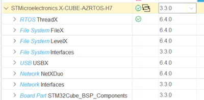

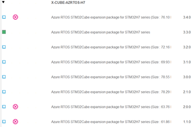

Thank you for your quick response. I found the Software Packs Component Selector and the STMicroelectronics X-CUBE_AXRTOS-H7 component.
Unfortunately, the only version is 3.3.0. I believe I need to install a previous version of the Azure RTOS expansion package.
But if a previous version is installed it may not be compatible with my version of CubeMX. I believe I have to except this inconvenience.
