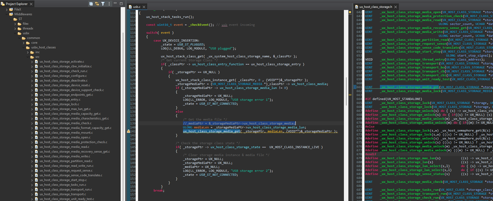

I am trying to understand what to do about this block when I am running in standalone mode. I started from an example code which is in RTOS mode but I want use the standalone mode.

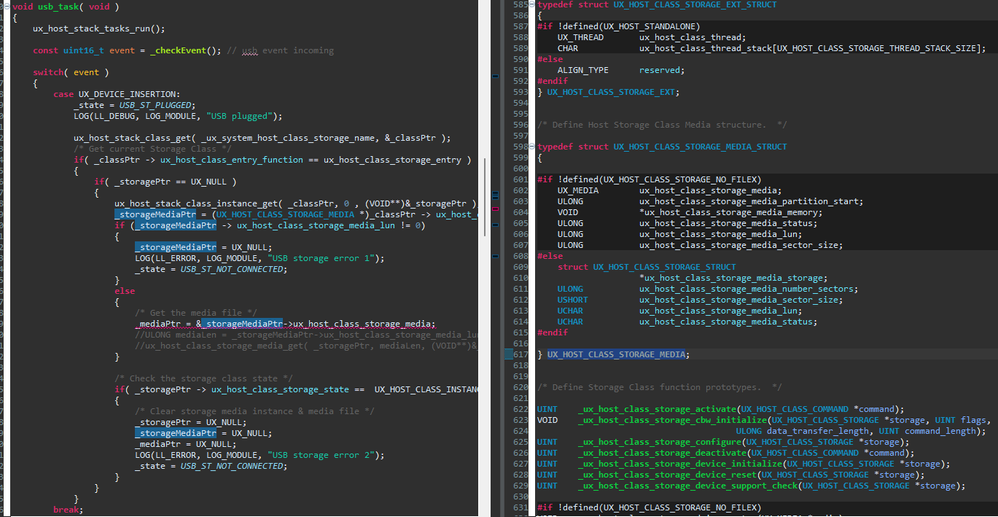

When I tried to implement something meaningful in UX_DEVICE_INSERTION status, it turns out that the expression
_mediaPtr = &_storageMediaPtr->ux_host_class_storage_media;
fails to compile because  'UX_HOST_CLASS_STORAGE_MEDIA' has no member named 'ux_host_class_storage_media'.

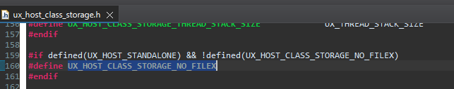

I think the problem is in this definiton:
but I need to use FILEX.
Than I tried the method 2 using the function 'ux_host_class_storage_media_get' but it is not present in the folder Middlewares/ST/usbx/common/usbx_host_classes/src
Which of the two methods should I use?  How can I skip the problems? Do I have to define something different?

I have the same problem with the function '_ux_host_class_storage_driver_entry'
It is unreachable due to the #define UX_HOST_CLASS_STORAGE_NO_FILEX

I think that the logic host storage class in standalone mode allow users to use file system in applicative side (filex, fatfs, .... ) in this case you need to customize  ux_host_class_storage_driver
