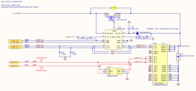

@JMarple1 I have exactly the same problem. After changing config from HCD to PCD (host to device) the code times out waiting for the OTG_GRSTCTL.CSRST register field to get cleared.
Btw, I am wondering if USB_CoreReset() function code is correct since RM0456, p. 3311 states:
"Once this [CSRST] bit has been cleared, the software must wait at least 3 PHY clocks before accessing the PHY domain (synchronization delay). The software must also check that bit 31 [AHBIDL] in this register is set to 1 (AHB Master is Idle) before starting any operation."
It seems that the above indicates that first CSRST needs to be set and cleared and then AHBIDL high state should be awaited, not the other way around.

@Riscy@JMarple1, I got it working, those three posts may shed some light:
I shared complete, working solution for Nucleo STM32U5A5 here:
tdjastrzebski/Nucleo-U5A5ZJ-USBX (github.com)
Just keep in mind board needs to provide USB-C power. For that undocumented SB8-10 jumpers need to be shorten, additional JP6 jumper in 5V_USB_C position is required.

TDJ
Lead
@Riscy Since more engineers seem to be interested in this topic and ST is not helpful, I placed my solution on GitHub and added some pics tdjastrzebski/Nucleo-U5A5ZJ-USBX (github.com)

FBL
Hello @TDJ
Thank you for bringing to our attention. An internal ticket is submitted to include these details in HW setup in UM2861 as stated in schematics.
Internal ticket number: 171723 (This is an internal tracking number and is not accessible or usable by customers).
