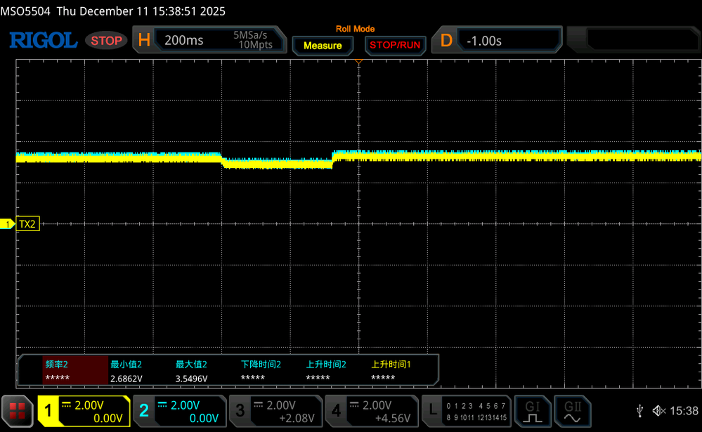

I'm currently working with the STM32U585 and encountered an issue related to GPIO behavior after waking up from standby mode.
Before entering standby, I configure certain GPIO pull-up:(No external pull-down resistors on the affected pins)
HAL_PWREx_EnableGPIOPullUp(PWR_GPIO_D, PWR_GPIO_BIT_14);
HAL_PWREx_EnablePullUpPullDownConfig();

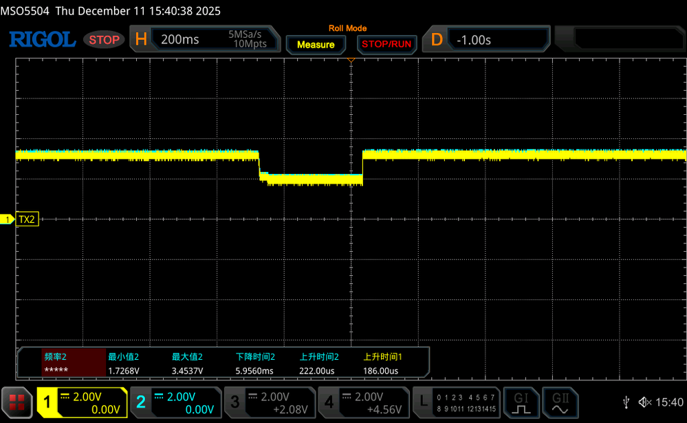

However, after the MCU wakes up from standby (via wakeup pin), I observe a brief voltage drop on those previously GPIOs, about 300ms. This drop occurs before the firmware reinitializes the GPIO configuration:
i added a delay(implemented with i--)before calling the HAL_Init() function, and the voltage drop became less pronounced:
Questions:
  1. Is this behavior expected due to the standby mode reset mechanism?
  2. Is there a recommended way to retain GPIO output levels across standby wakeup?
  3. Could this be related to the IO pull settings or the boot configuration?
  4. Are there any hardware-level workarounds to avoid this voltage dip?
  5. Why does delay have such an impact
