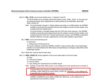

Oh, indeed - if a CRC calculator is fed by one byte only (0x80), the result is 0x6800520C as reported.
A nasty gotcha, changing the Cube/HAL's API between families! I see that this matches GPDMA's BNDT behaviour but still - Cube/HAL is supposed to be there to facilitate porting, which it fails here obviously.
Nonetheless, in this case, the DMA has been set to transfer words at both ports, wasn't it. And the RM says this:
so GPDMA shouldn't have transferred even that one single byte, but should've thrown the user setting error, which doesn't appear to have happened.
@Khaled_DHIF, can you please comment?
